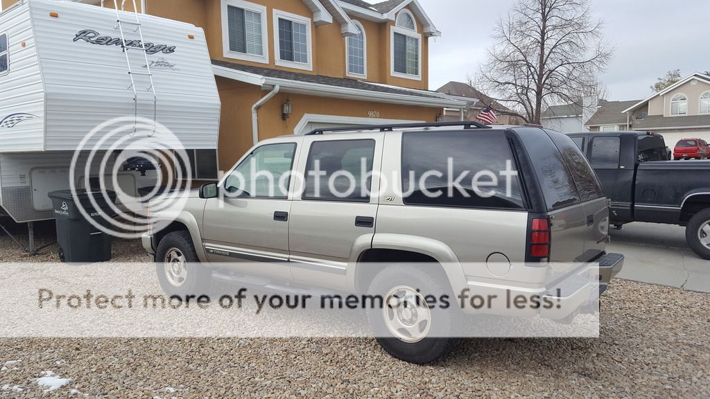

Just picked up this gem for the mere price of $600. I think the wife has claimed it already tho. Anyway has no compression on #4 so hoping its just in the heads. Interior need a good scrubbing so little time and a little elbow grease I hope to have this turd polished up!

So it appears to me its dropped a valve seat on cyl#4, no compression and leakdown test fills a glove over the tail pipe. the exhaust valve tip is also lower than the intake valve, backing off rocker immediately makes rocker loose, so no preload. Also see slight piston contact through my borescope, valves cant really be seen. They are the 062 castings, I do have a pair of 906 castings laying around but condition is un known. Machine shop says he almost always sees the 906 heads cracked. So Im thinking buy new GM heads and slap this thing back together. So are the 12558060 heads what I want from GM?

Well theres your problem!
Found some heads locally for sale for a good price and was able to get it all tore down and back together in a weekend
Put a new spider in just because
Got the inside all scrubbed down to with some help from my wonderful helper! this thing was filthy!
