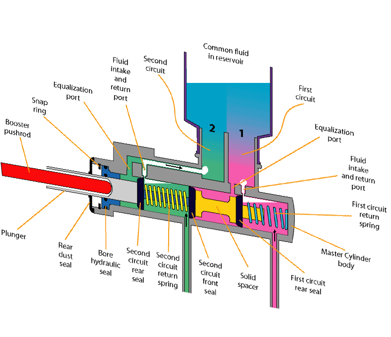

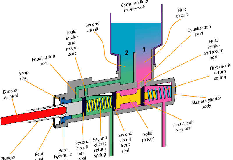

Why air stays trapped in the system if it won't exit by itself.
The intake and return ports are tiny orifices and it's possible that the air won't escape because of surface tension.
The orifices are at the top rear of each cylinders and as you can see, it's impossible to bleed the air with the front up.
You can't pump the air out cause as you can see, pressing on the piston closes the escape hole
This is what I suggested to do if there is actually air trapped in the MC
Tapping on the end of the MC with a piece of wood could vibrate the mc enough to burp the bubles.
But I suggested compressing the calipers.

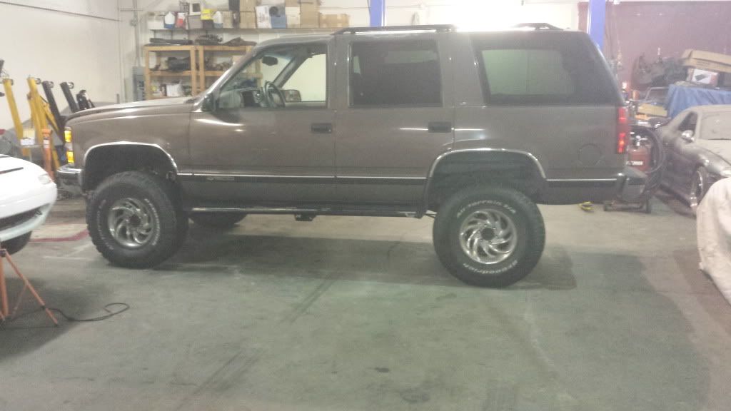

Drove over 200 miles Monday to get some deeply discounted tires and wheels. Gotta love Craigslist. I'll show pics after they're mounted.
She still purrs and shows no signs of leaks, rattles, or whines. Temp and oil pressure held steady as a rock. The only time the temp moved from 190 deg was when I was in stop and go traffic in downtown SF. Temp crept up to 205 or so.
The brakes were serviceable but, for reasons previously mentioned, I kept some extra distance from the cars in front of me.
jakenatour
Posts: 316
Joined: Wed Aug 15, 2012 10:48 am
Location: '97 Tahoe, 4DR 4WD Vortec L18, 4L80E
Post by jakenatour »
Here's the wheels installed.
These are Toyota wheels, unpolished, with garbage BFG All Terrains installed 315/75/R16 (~35" diameter, 12.5" wide). Craigslist $140
Not crazy about the look of the wheels. I have the center caps. I'm toying with painting them satin black with a rattle can.
Picked up some brand new BFG All Terrains to mount to these wheels. Same size. $850 which is a steal.
What's your vote on the wheel color: Black or Natural?

Ever thought of Plasti dip rattle can? Can be peeled off if you change your mind.

I vote for black wheels, but keep your center caps chrome.
Tahoe is looking good.

Two cans of PlastiDip black just purchased. I like the minimal prep, undo option. I'll get that shot next week.
