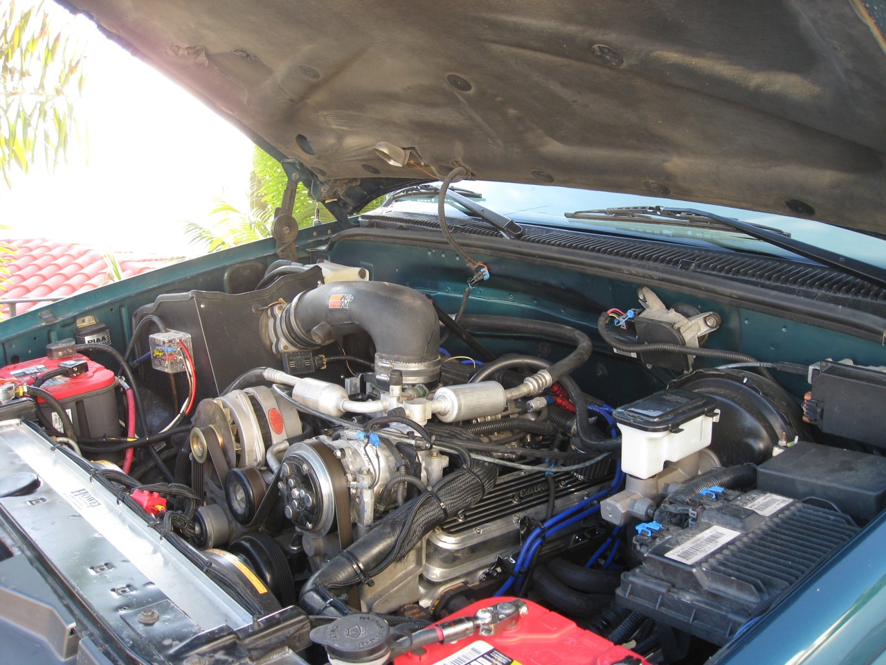

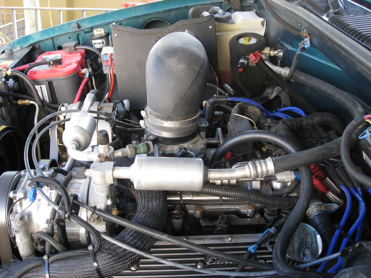

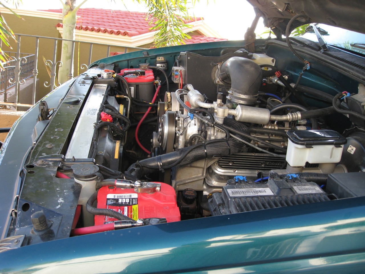

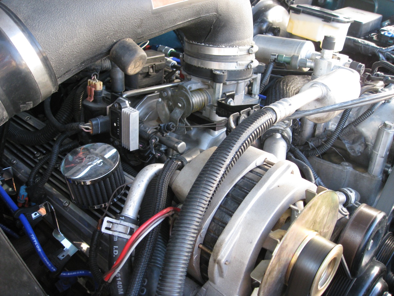

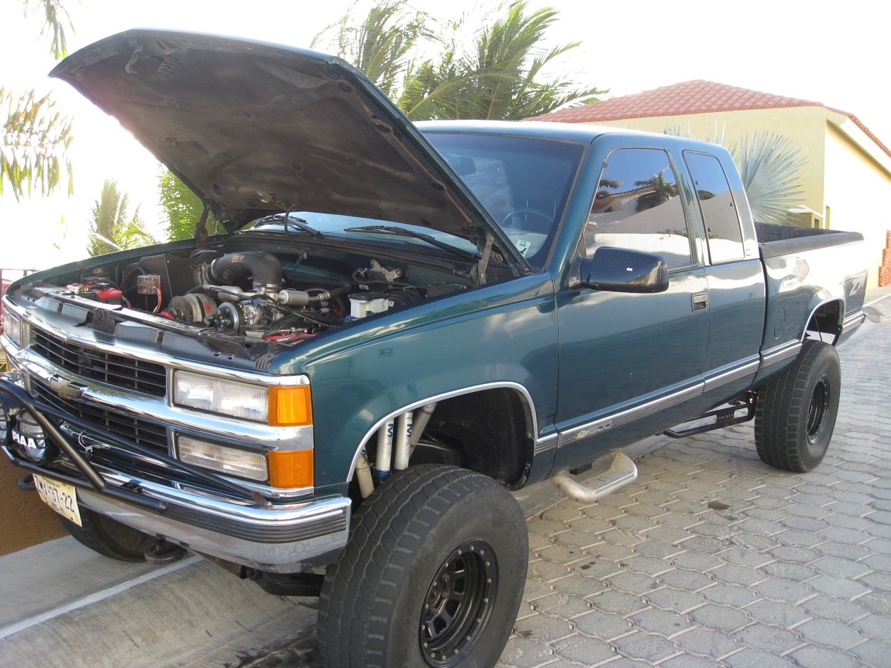

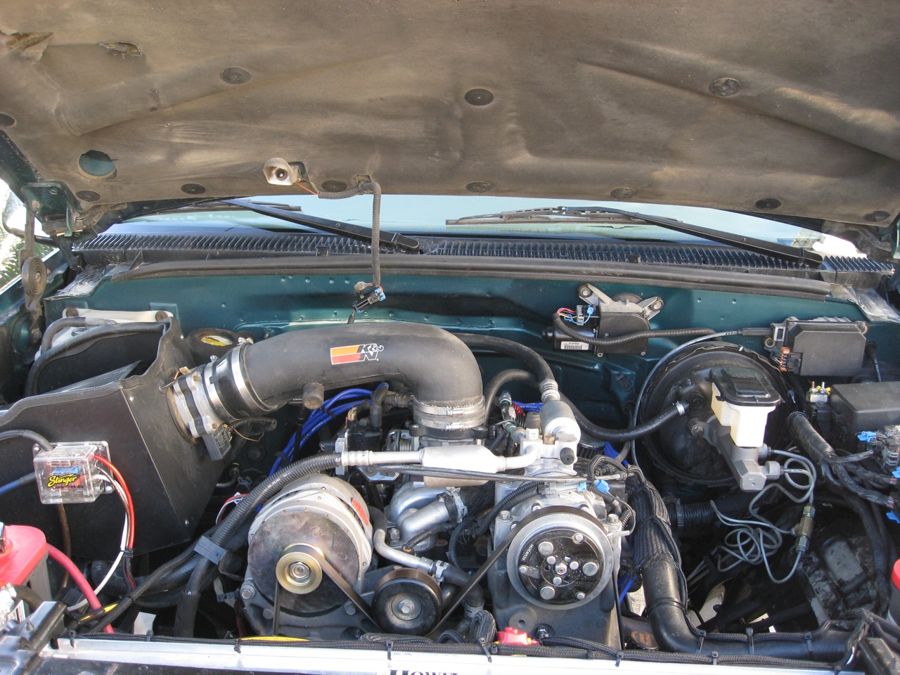

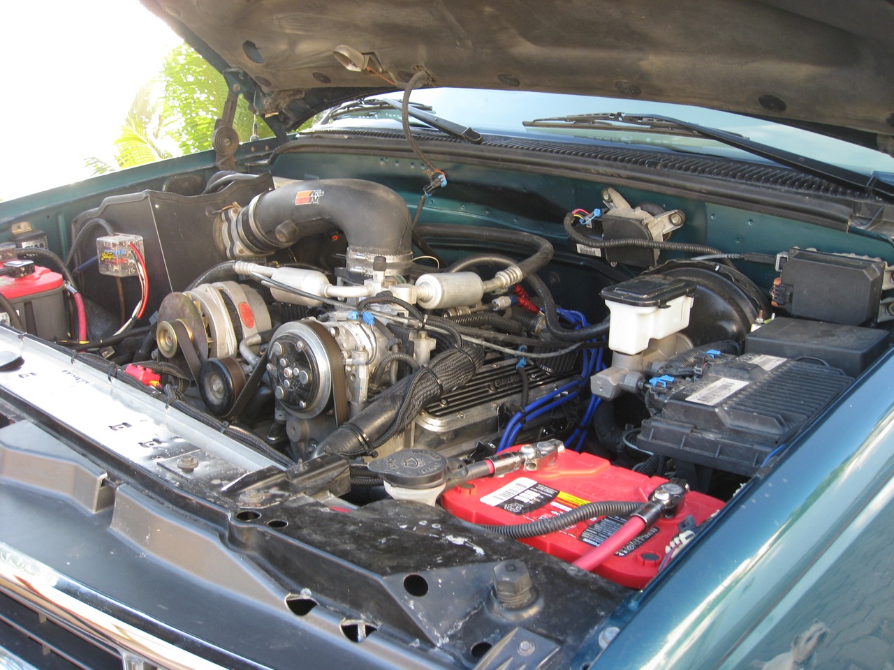

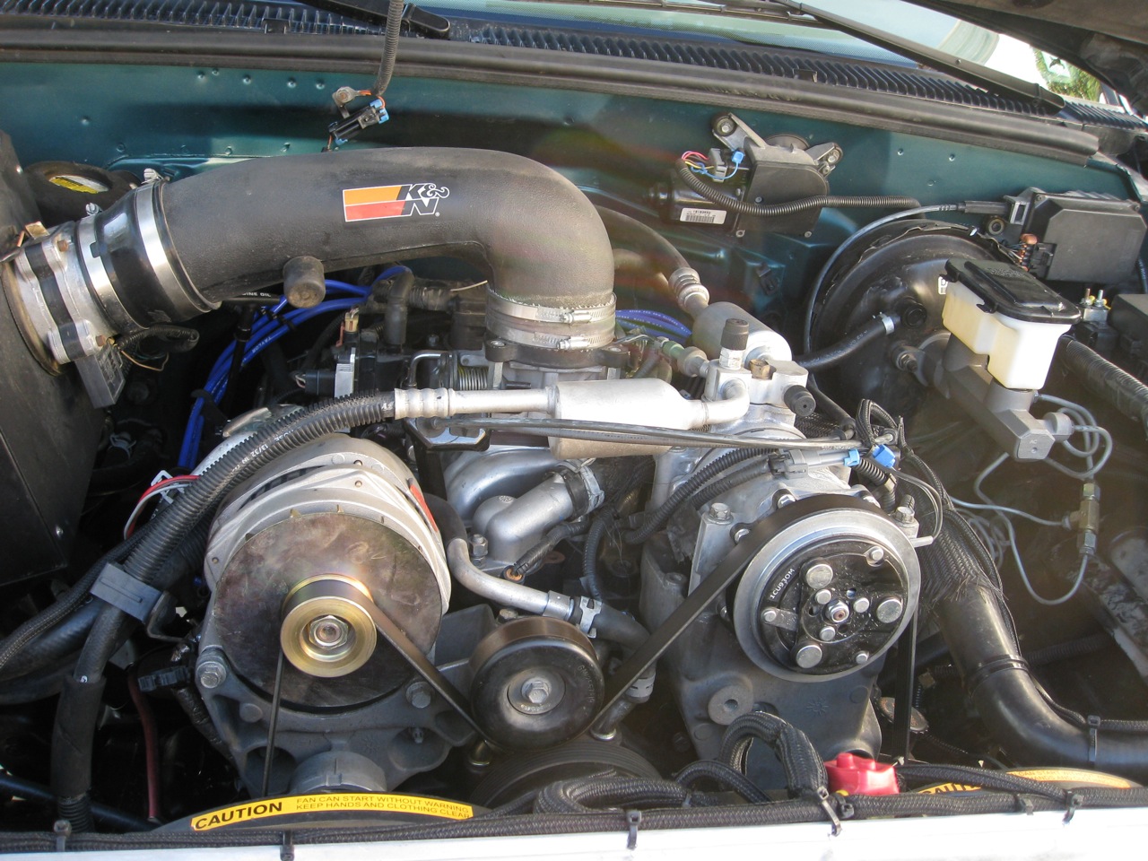

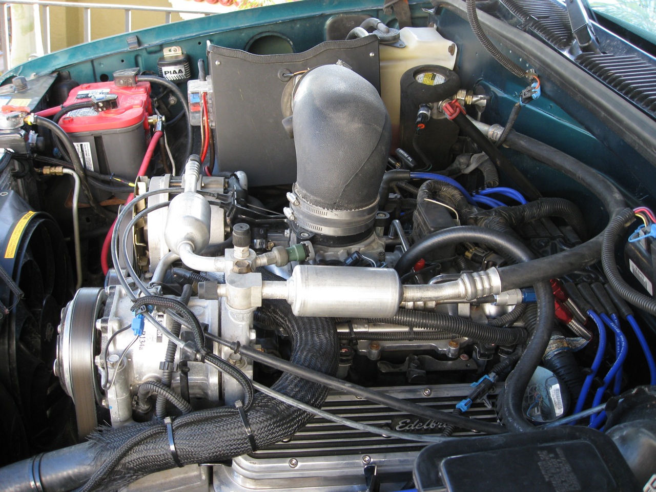

 A few pictures

Hey Hog,
This is a 97 k1500, but as you can see it has a 6" lift, and 35" BFG Baja's. The Tranny is a 4l60E that we just installed a complete rebuid kit from ProBuilt https://www.700r4l60e.com/store/product.php?productid=328&cat=22&page=1 It seems to be pretty strong for now, but I am just waiting for it to give before I do the 4l80e conversion.
You are right, there seems to be a big surge of power in the 4000k range. It also pulls hard when you are cruising at 70 and nail it.
BTW in those videos the tires were at 32psi

How's oil consumption, if any?
Are those breathers making a mess yet?
| Mon Aug 02, 2010 3:30 pm |
