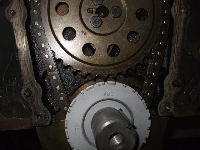

James B. wrote:
This new thing sure fits nicely on this old thing...
James, do you have the part number for that big block 24x reluctor? my brother has a big block and wants to 411 it with the individual coils.
