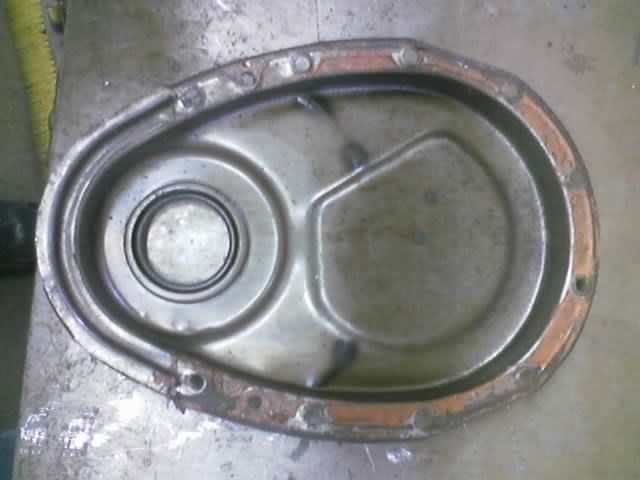

Hope this works This should be the inside of the 2 covers.
Good work! All that from what I posted? Damn S10mods, you are really bright!! Kudos! Photobucket has a tutorial, right? Did you use it?

Stealth97 wrote:
I dident read anything I just figured to copy and paste the img link here. Then it worked. I have some computer skills.
I woulden't think that the aftermarket cover would need the 2 pegs that are on the plastic cover. The old style blocks use pins in the block for location. It only needs 10 bolts.
