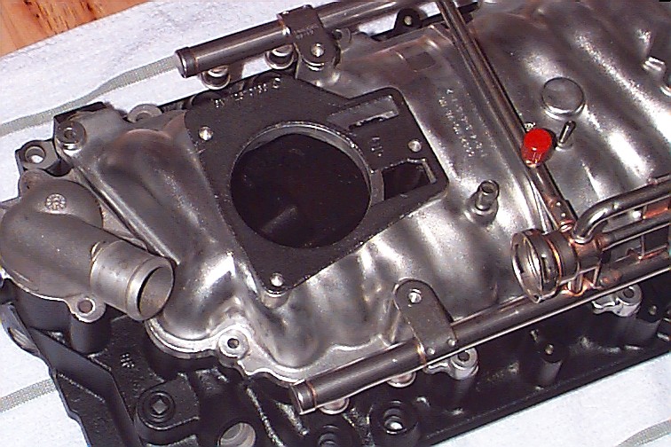

1. The Marine Intake Manifold has no provision for a thermostat bypass like the stock manifold. (See PIC)
SOLVED
The manifold casting does have the appropriate internal structure and enough metal to drill through. (See PIC) Some creative use of cold weld or epoxy is required inside to make sure the tapped hole is a sealed passageway through and into the internal structure. (See PIC)

5. The Marine Intake Manifold throttle body (See PIC) does not have the EGR diffuser plate (lip) or the hole to diffuse the EGR coming up under the butterfly. (See PIC) This is fine because the pipe inside is directed toward the rear, not up like the stock manifold.
NOT USEABLE
This TB does not have the proper connections on it for throttle and cruise control cables making it unusable anyway. Also, the TPS and IAT are not the same parts as stock even though they appear to be at first glance. (See PIC) The return spring rate is also all wrong. The blade used in the TB would seem to have desirable qualities but the holes in it holding it to the shaft in in different places than the stock unit. The marine TB also has different bearings for the shaft which prevents any interchang eability between the Marine and stock units.
6. Throttle Body sits forward on the intake like the stock unit meaning that aftermarket intakes will work with this manifold. The TB mounting flange of the marine manifold is exactly in the same position and height as the stock manifold. This makes the L31 Marine manifold the ONLY true MPFI intake manifold compatible with bolt-on superchargers and cold air induction kits.
7. The upper intake manifold does not have an integrated gasket for the throttle body like the stock manifold does. Instead the Marine setup has this seal integrated into a channel in the throttle body. Since the Marine TB cannot be used, a gasket is needed between the stock TB and the upper manifold. (See PIC)

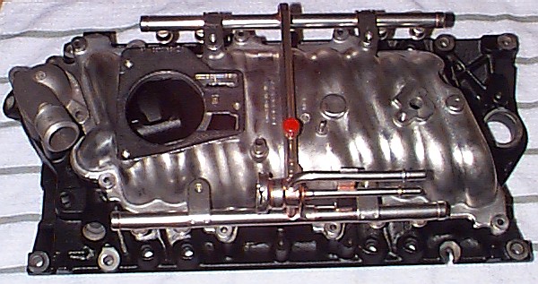

8. The fuel rail has 3/8" and 5/16" quick-connectors like a Gen-III manifold. (See PIC)
9. Entire fuel rail is stainless steel and brazed together as a single unit with no possibility of leaking. Fuel pressure regulator has a lower pressure than stock at about 50-55psi instead of 60-63. (See PIC)

11. PCV routing is a little different but will work. (See PIC) I heated up the stock plastic tube to straighten it out. The tube connects to a 90-degree checkvalve that PCV needs with forced induction.
12. There are no ports for all the EVAP stuff. An existing nipple can be tee'd and external divorced adapters can be fitted to the various EVAP parts and plumbed in.
13. The lower manifold is cast iron. (Yes, really, and very very heavy.)
14. There are mounting points miscellaneous stuff like the coil, but they are in a different place. The coild can be mounted directly to the intake manifold between the two pair of injectors. The drilled holes in the manifold are about 1/16" closer together than the holes on the coil - the coil holes can be enlarged to fit. The forward ear of the coil assembly needs to be cut down to clear the #4 fuel injector if wide-body injectors are used. Also, the module and heat sink need to be unscrewed from the coil bracket and flipped over to put the harness connector toward the rear. The wiring harness can not reach it otherwise.
15. The stock wire harness bridge will not fit.
16. There is no drain hole in the bottom of lower manifold because it's flat with no cavities. This is a good thing.
17. Stock heater-hose quick-connector will thread right in.

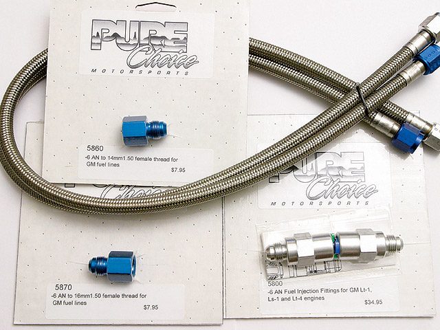

23. Fuel lines with Quick-Disconnects are needed. (See PIC)
MULTIPLE SOLUTIONS
There are a few companies making QD to AN to O-Ring adapters and lines. (See PIC) The line used for OEM installations of the Marine Intake are about 34" long with o-ring and QD ends. (See PIC) It is possible to cut off the o-ring ends and clamp onto the stock hardline under the footwell where the stock hardlines make the transition to flexible line.
PREFERRED SOLUTION
Pure Choice makes quick-disconnect to -6AN Male Flare adapters. Part# 5800 (See PIC)
For the lines on the firewall two female o-ring to -6AN male flare adapters are needed from Pure Choice, one 14mm 1.5 thread and 16mm 1.5 thread. These are part numbers 5860 and 5870.
Two -6AN fuel lines with female flare on both ends are needed, one 6" long the other 7" long.
The optimal solution is to use 45-degree -6AN fittings at one end of each fuel line. This solution ends up needing one line 2" long between fittings and the other 1.5" long. (See PIC)

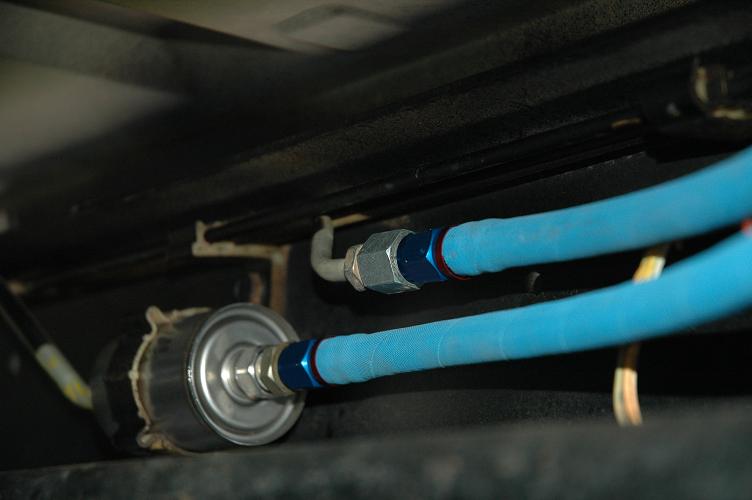

Here's what I did for my fuel lines, same situation as you guys-
Pure choice LS1 quick disconnect to -6AN, -6AN aeroquip socketless hose connector:
Aeroquip socketless hose connector, -6AN to 16mm male saginaw fuel filter fitting, -6AN to 14MM female saginaw fitting for return. Pure choice carries these too I think:
Ended up being about $75 I guess.
