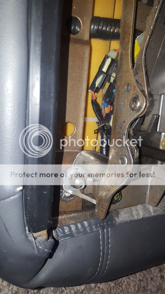

Didnt look on the site but pulled my seat friday night to ohm out the heater and just verify. Found my frame was broken anyway. Went to the U pull yard and found a seat with a good frame and heating element, leather is trashed but its got what I need to get going again. Also ordered new leather.

Aparently the PO thought a door striker was a good way to fix a broken frame.

Cool huh? Im glad i got a junk yard seat cause that seat frame was bent like crazy
