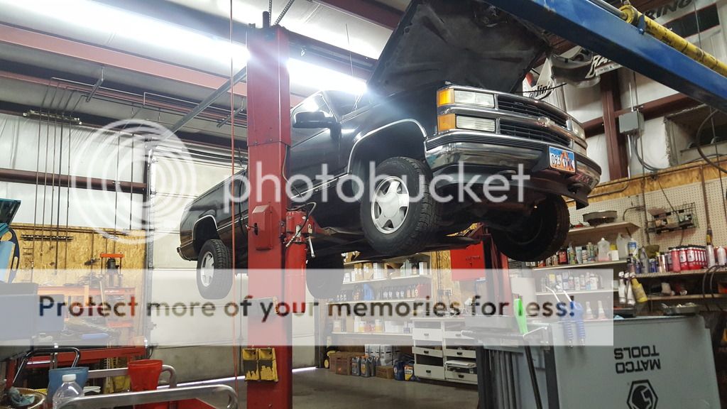

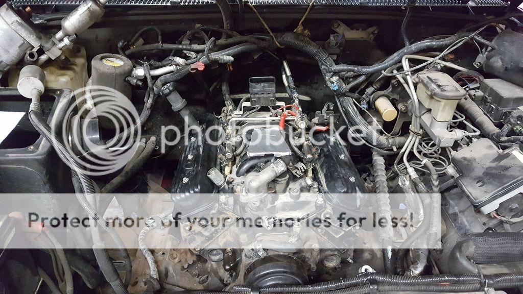

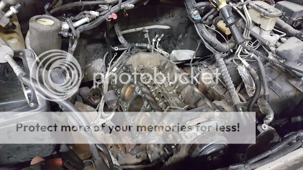

So I lost a head gasket on my truck. Went out to start it one morning and it was hydro locked. Drove the toilet to work and came home and pulled spark plugs. #8 was full of coolant but the dipstick was clean. Did a leak down test on #8 and bubbles where coming out the radiator.
So that was my fun for the weekend. My question is why did it fail like that?

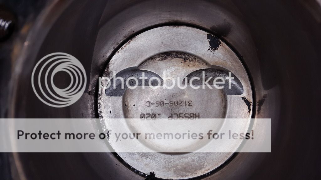

Too much torque on the bolt? next to the failed portion.
Manufacturing defect?

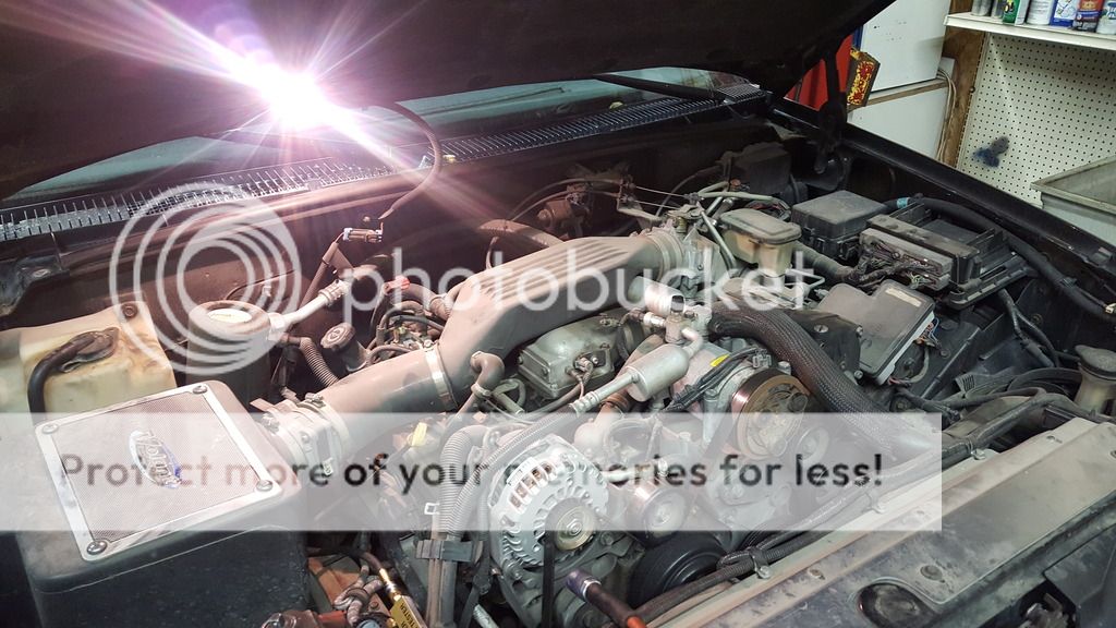

I had problems with gaskets on mine too. Failure between #4 and #6 in the OEM gaskets, FelPro 1010 gaskets after that blew out and leaked too.
Third gaskets on it were Cometic C5474-040 under the Edelbrock E-Tec 200 heads. Cometic has been in everything built since and always will be. They'll work with iron too.
Well I did get almost 10 years and 60k miles out of them so I can't complain too much I guess.
I will say my truck seems to run better than it has in a couple years now. I have never been able to get my CMP offset perfect it was always at least 5* out. Found I had to turn my distributor gear 180* and I got it nailed.
