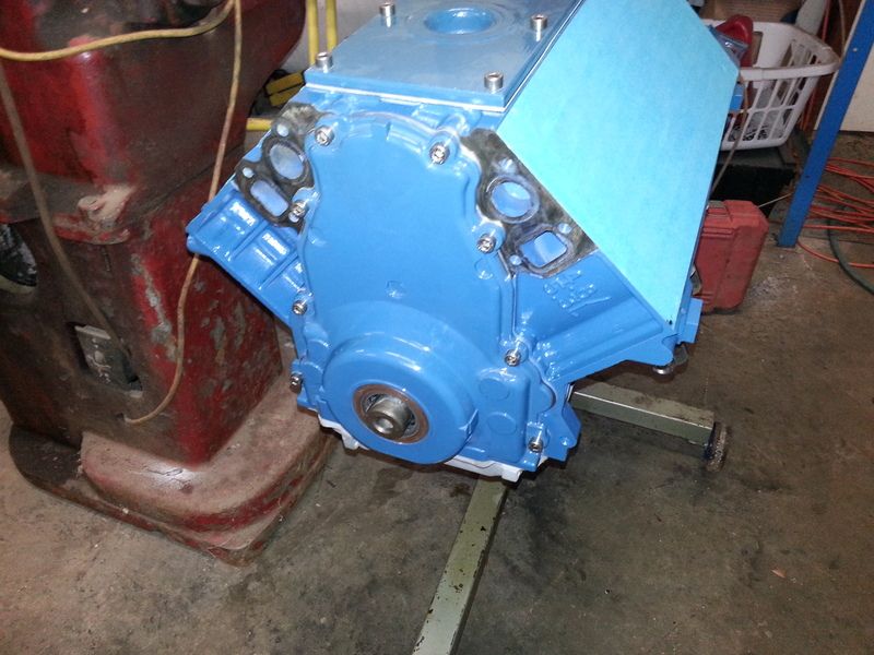

Well this build is still going,just very slowly.
I put it on hold due to funds and time constraints but about to get back on it.
I made an executive decision to hold off on the build and buy some needed shop equipment.
Now i'm equipped well enough now that this stuff won't take hours upon hours since I work in my shop alone.
Also Now I can be making easy money in the shop
I stopped the gofundme for the van for a few reasons,basically it failed. Also I felt like a shit for even starting it,especially after looking through and seeing all the other people with serious needs (pretty sure I donated more back than I recieved lol).
I did find a local girl though in the process needing a wheelchair van,her name is same as my daughters with similar diagnosis even just not as severe.
So the goal is still hopefully to give away the old van if we can,money be damned.
So right now where i'm at.
Shortblock is built,heads are ready to be put together,van needs to be pulled in and the powertrain yanked from it.
Haven't touched the tranny yet,I bought a trans mounts for my worktable but still need to make/buy the mounting piece for it.
I need to clear out a couple cars I bought to sell and scrap this week,finish cleaning out shop and then hopefully pull the van in.
I can now currently only fit 2 cars in my shop,one project in the back (spot is filled) and the spot for the lift.
I try to keep to a one day rule on the lift,so whatever rolls onto it can be easily moved back out in case I need to use it.
I'm gonna make another thread to show off the new shop stuffs that's fun.
