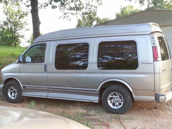

Here she is.
Needs cleaned up inside,new driver seat cover and miscellanous body kit stuff.
Also has a few dings here and there and the hood is ravaged by hail looks like.
New hood and a deal with our paintless dent repair guy should solve most problems.
Gonna verify the engine has a blown head gasket first off,if it is sucking coolant in from a bad intake gasket prob just change it and worry about swap after the frame and floor modifications.
My chevy tech buddies are gonna keep an eye out and i'm going to cruise some larger pullaparts when i'm in dallas next week hopefully and take pics/compare to see if the swap is simple.
Near as I can tell,mine being an '02 has the standard gmt400 suspension.
Looks like it changed to the silverado stuff in '04.
Still reading,getting ready to make a plan of attack.
Wish I wouldn't have dumped $6k into the Ford van already.

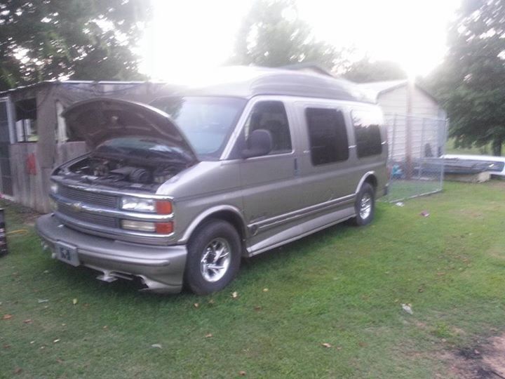

A buddy of mine who is a local Chevy tech stopped by today and wanted to look at the van.
He talked me into firing it up and putting the scantool on it for the hell of it,we're not confident of the buyers diagnosis.
Mode $06 showed cyl 5 and 4 misfiring and we noticed it was getting hot so killed it to check coolant.
Lol we found the top radiator hose disconnected and no fan or clutch installed.
I don't even wanna mess with diag now,just yank it.
I liked the idea of maybe fixing a bad injector and driving it while I saved up money but eh.

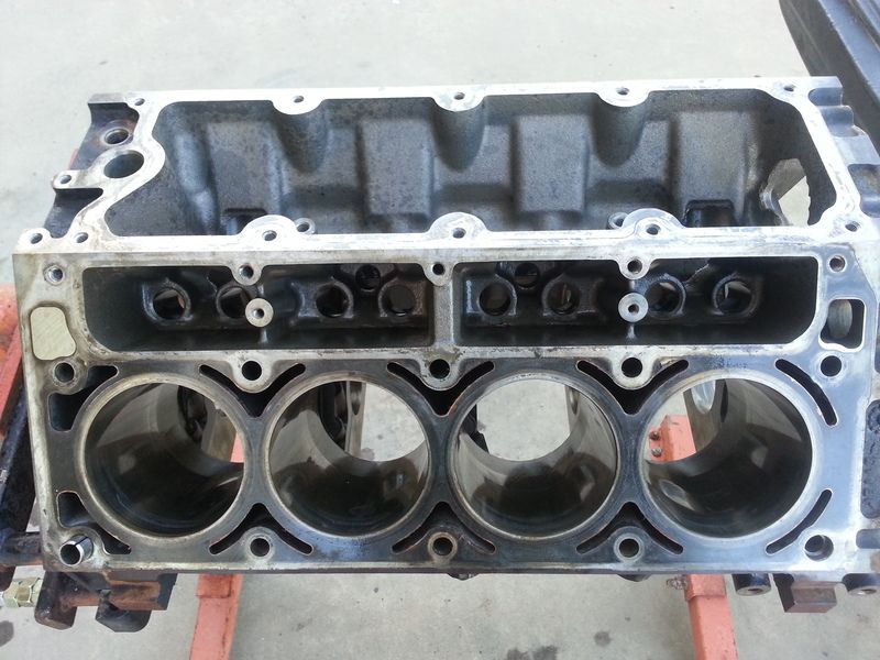

Small setback,gonna have to decide how to proceed.
Not sure how I missed it,hell I can see it in a pic I took last week cleaning the shortblock up.
Block is cracked,unuseable and not gonna waste time or take the chance attempting repair on this application.
But,on the good side i've gotten the heads cleaned up and ready for valve job then put together.
Basically just gasket matched,cleaned up valve guides and knocked off the sharp edges.
I can go a couple ways here with what i've got onhand.
I actually have an LQ4 on a cradle under my loft I was going to go all out on for my s10 later.
I also have been cleaning up a 4.8 at work same time as the 5.3,currently sitting in exact same state as the 5.3 sans block cracks.
The 4.8 won't have the power I want,mainly torque for towing. It could,but i'm already off budget.
The 6.0 will make plenty of torque easily,but there goes gas mileage.
So probably just put the 5.3 rotating assembly in the other block,hell considering using the pistons as well but not sure I want that much compression and the need to run premium.
Regardless which I choose,now it's a full rebuild as either choice will need cam,crank and rod bearings.
Maybe i'll find another block also though,and still throw together the 4.8 to sell off for funds.

I haven't seen one crack like that. I wonder what sort of torture it took for that to happen.
Probably froze is my bet

I tend to think it froze too. Freezing can do a lot of damage.

The 4.8 block is also the 5.3 block, so if you really want a 5.3 and the rotating assembly on the 5.3 is OK you can put it in the 4.8 block. If you check the back of the block you should see 4.8/5.3 stamped into it. Just don't let Hunt Engines touch it. They're behind the GMC dealer that's between Towson/HWY 71 and 540 in Fort Smith.
I'll also add, if you put the 4.8 rotating assembly in a 6.0 block, you have pretty much the same stroke and bore as the old style 327.

Anyway,I stripped down the 4.8 I had and now have a good block.

So currently where i'm at is prepping the block.
Unfortunately no funds to square the block up or anything so she's going together with just new bearings and no machine work other than the heads.
Got the double roller timing set in,I just use the duralast branded set from Autzone that is made by SA gear.
I've used it on a couple other builds with good results and it's only $120.
Still need to go over the crank and all the rods and mic them to verify for bearings.
Also need to order new rings.
