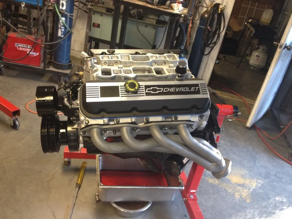

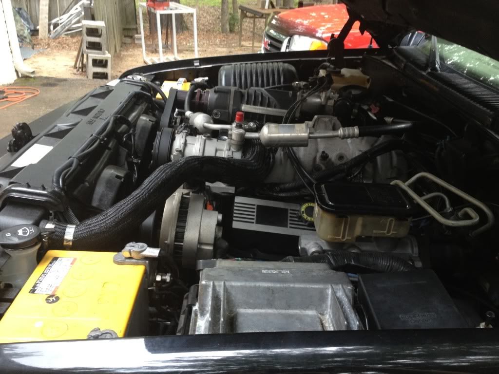

I ran across this video I took just before selling the truck with the gen 6 based (460ci) bbc. It was a 0-105 ish mph run In 4hi
It would have been a lot quicker if it had smaller non mud tires (285-75-16) and it was a tiny 1.6L Lysholm/Whipple blower non intercooled. There was a bunch more potential there, it's just how much do you want to spend to get to (X) fast lol
A rear mounted turbo would amaze you on your stock setup.
This was some pictures of it

Looks nice and always love the sound of the blower whine!!!
Its funny you mention a rear mount turbo, i had one in mine when doing the 8.1 swap, and have been thinking about doing it here as well. But will get it up and running NA first. Also been looking into doing the ZZ502 heads cam and 502 ram jet intake swap as well down the road, was gonna do the ram jet on the stock 7.4 but apparently it doesn't fit without some machine work, and for what one cost id rather put it on better heads than machine it for the stock heads.
