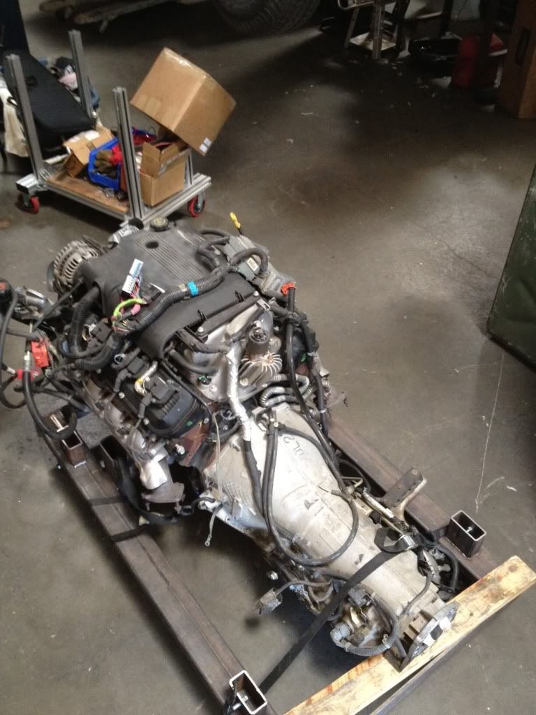

Post Delivered!
My new power plant was delivered to the shop today.
Here it sits, about 4 feet and right angles to where it will eventually bolt in.
Thanks for all your input!
