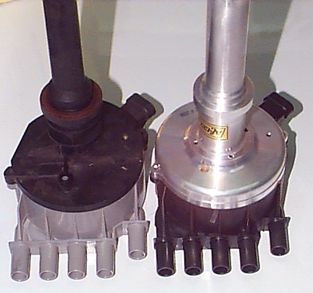

This thing is BEAUTIFUL. Very well-made. It accepts a standard crab cap and rotor and has an OEM hall-effect sensor. Best of all, the shaft does not taper down to that wierd unique diameter GM used for these engines. It's 0.491"!
That means all types of aftermarket gears are available, such as:

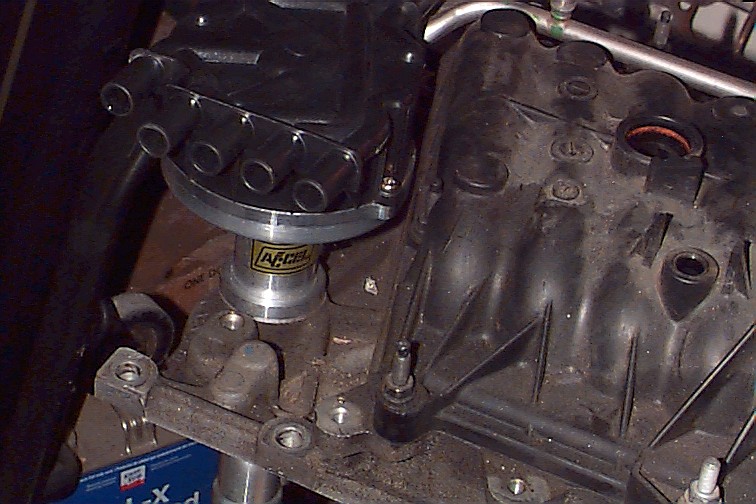

Post Installed today!

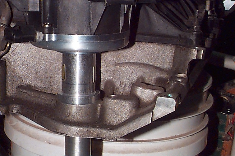

This distributor is a very precise fit in the block. I know this sounds rediculous, but I SWEAR it's true - I have higher oil pressure at idle now by about 5psi. I think it has to do with the notch I had in the plastic one for gear oiling combined with the tollerance of the plastic to iron bore.
When installed the rotor barely freeplays 1 degree back and forth! Also, the shaft in this does not move axially like the stock ones.
It was plug and play - very easy. To avoid P1345 I rotated the engine before pulling out the old one until the rotor was pointing dead at a screw-hole in the housing. I reinstalled the new one to the same orientation and it was perfect. Initially it's kind of hard to point the rotor because it drifts so far forward and backward in freeplay, so I just choose the middle.
I said it before but now even moreso - I am impressed with this part.
