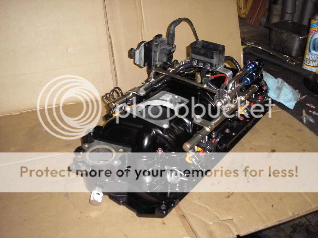

I used the 45 degree ends with one 1.5 and the other 2 you can kinda see them in this pic how they angle down this is the ideal way so the distributor cap will clear easily

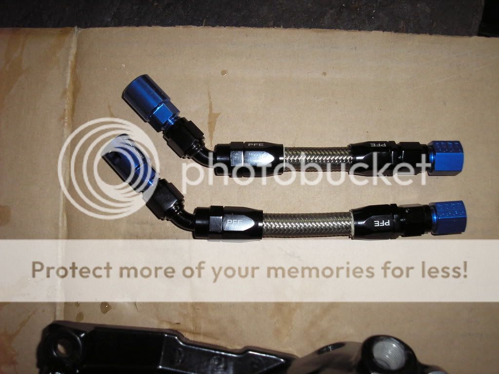

These are what the lines end up looking like
Heres some part numbers for all the fittings: There is on Female 14mmx1.5 "saginaw" EARLS part number is 9894DBHERL, One Female 16mmx1.5 "saginaw" EARLS part number is 9894DBJERL, One 3/8 Female quick connect to -6 male PROFLOW part number PFE808-02, One 5/16 Female quick connect to -6 male PROFLOW part number PFE808-01, Two 45 degree hose end -6 black PROFLOW part number PFE102-06BK, Two straight hose end -6 black PROFLOW part number PFE101-06BK. Hope that helps for anyone
