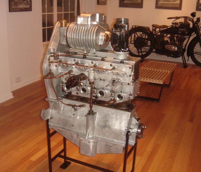

And this one designed by Mr. Skinner might interest Speeder;
Imagine this...4 cylinder, 2 stroke, supercharged and rotary valve. Yes, rotary valve...four of them! This engine was designed and built by Mr. Skinner in the New England area during 1928-1929. The engine mounts and bell housing mounts are common to a Ford Model A. I have learned that this engine didn't have success in auto racing due to cooling challenges and was later used with better success (and cooling) in a race boat.. The engine was acquired together with the complete set of beautifully constructed wood patterns for sand casting. Interesting Technical Features: 1)water cooled cylinder block and head is cast as one unit from grey iron; 2)upper crankcase, oil pan, front chaincase and manifolds are aluminum sand castings; 3)supercharger is by Switzer-Cummins of Indianapolis, Indiana; 4)carburetor is a downdraft Stromberg; 5)cylinder head is machined to run two spark plugs per cylinder; 6)exhaust vents to atmosphere at BDC out the right and left side of engine (eight exhaust pipes); 7) although the engine is two cycle, there are no transfer ports; 8)whereas most four cylinder engines have a firing order of 1, 3, 4, 2 this engine has a firing order of 1, 4, 2, 3; 9)crankshaft big end journals are at 90 degrees to each other, counterweights are knife-edged and there are five pressure-fed main bearings; 10)pistons are flat top with three compression rings each (no oil ring); 11)each of the four rotary valves are shaped like a shot glass, only about twice as tall.
Each rotary valve has a slot in it that opens to the combustion chamber. The following is the mapping: (1) intake begins to open when the exhaust port is 50% open; (2) intake is 100% open when the exhaust port is 100% open (must have shot flames!); (3) intake begins to close when exhaust port is 50% closed; (4) intake is 100% closed when the exhaust port is 100% closed. Understanding this mapping, and the lack of transfer ports, explains the need for the supercharger. There is no event that will draw in the intake charge naturally. Mr. Skinner controlled the effective compression ratio by timing of the rotary valves and by positioning of the exhaust ports. He first ensured that complete scavenge of the spent charge took place and then closed the ports and rotary valves on pure intake charge which is only then compressed by the remaining piston travel available above the top of the exhaust ports. It is said that "everything old is new again". In the case of the 1930 Skinner prototype, this same thought process is being introduced in Uniflow diesel engines for both trucks and aircraft today.

Dang that stuff is cool I bet that 2 stroke motor makes some power
