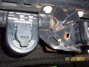

The GMT800 receiver is a piece of junk. I've been discussing it over at rv.net for a
few years after someone from my church asked me about it.
I'm not up on the various brands, but again it should be designed properly and have
proper manufacturing metrics in place.
A receiver uses the WD forces (class IV) to lift the TV (tow vehicle) rear end and removes
weight to transfer (distribute) to the TVs front axle. Some goes back to the trailer's tongue.
In doing this, the cross tube (round, square, etc) twists (torque tube) to lift the TV rear
and distribute weight to the TV front axle.
Here is one link to an article and some pictures.
http://www.rv.net/forum/index.cfm/fusea ... page/3.cfm
I'm not sure on the GMT900's, as it is now welded onto the frame and think another poor
design. As it now only has a Class IV WD rating of 1,000 lbs.
http://www.rv.net/forum/index.cfm/fusea ... m#19985830
